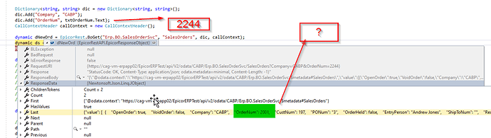

When we use “BoGet” we get a dynamic object that has a responsedata - but I can’t access this in the same way. I am also trying to get a particular record but it’s bringing back another:
so on Sales Order a trace reveals:
I thought I would be able to access this ‘dataset’ (I appreciate it isn’t a real dataset - more a dynamic object).

I’m not sure I totally follow.
To access the response on your get you have to go
ds.value[0].OrderNum
Since it returns an array of orders value is an array and needs to be trated as such. Hopefully that helps.
You are using the oData method here so you don’t get a dataset if you want a dataset you need to swithc to custom methods. GetByID()

First thing - I passed the order number in and thought that this would only show the one order not 100 of them:
Dictionary<string, string> dic = new Dictionary<string, string>();
            dic.Add("Company", "CABP");
            dic.Add("OrderNum", txtOrderNum.Text);
            CallContextHeader callContext = new CallContextHeader();
            dynamic dNewOrd = EpicorRest.BoGet("Erp.BO.SalesOrderSvc", "SalesOrders", dic, callContext);
