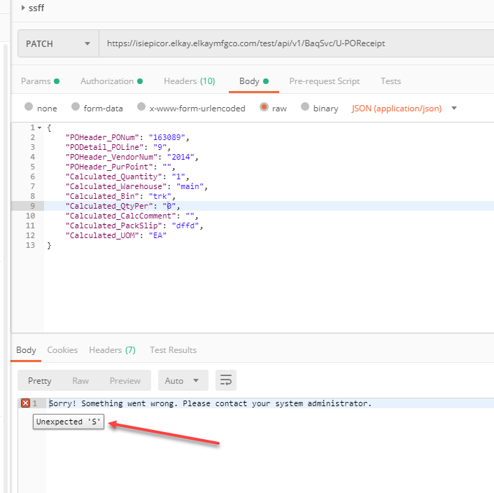

REST Patch to uBAQ Failing Suddenly
So, I have this uBAQ that executes a PO receipt which has been working since probably October.
I went to play around with it today and when the REST executes it’s giving me this message: “Unexpected ‘S’”. I haven’t touched the uBAQ or the code in months. I’m not entirely sure how to diagnose that error. Does anyone have any thoughts?
Postman:
Error from VS

If I update via the BAQ GUI, it works properly.
How do I add REST tracing and where do I view the output?

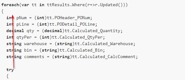

Paste your BPM code
callContextBpmData.Character03 = "";
foreach(var tt in ttResults.Where(r=>r.Updated()))
  int pNum = (int)tt.POHeader_PONum;
  int pLine = (int)tt.PODetail_POLine;
  decimal qty = (decimal)tt.Calculated_Quantity;
  int qtyPer = (int)tt.Calculated_QtyPer;
  string warehouse = (string)tt.Calculated_Warehouse;
  string bin = (string)tt.Calculated_Bin;
  string comments = (string)tt.Calculated_CalcComment;

Hmmm and if you run it in POSTMAN it doens’t work either…
Any new BPMs in Receipt BO?
Also for giggles add “RowMod”:“U” to the call
POSTMAN fails with “Unexpected ‘S’: Sorry! Something went wrong. Please contact your system administrator.”
No new BPMs.
Adding the RowMod yields the same result.

   at System.Runtime.ExceptionServices.ExceptionDispatchInfo.Throw()
   at System.Runtime.CompilerServices.TaskAwaiter.HandleNonSuccessAndDebuggerNotification(Task task)
   at System.Web.Http.Controllers.ActionFilterResult.<ExecuteAsync>d__2.MoveNext()
--- End of stack trace from previous location where exception was thrown ---
   at System.Web.Http.Filters.AuthorizationFilterAttribute.<ExecuteAuthorizationFilterAsyncCore>d__2.MoveNext()
   at System.Web.Http.Dispatcher.HttpControllerDispatcher.<SendAsync>d__1.MoveNext()
   at System.Web.Http.HttpServer.<SendAsync>d__0.MoveNext()
-------- Inner exception --------->>>
Object reference not set to an instance of an object. (NullReferenceException)
   at Epicor.Customization.Bpm.UbaqA717119B01384F4094F036AA13510AB5.UpdateBaseDirective_UpdateBase_3EE6E2ED1CCF43E2BECD5F68EF0AAFDC.A001_CustomCodeAction()
   at Epicor.Customization.Bpm.UbaqA717119B01384F4094F036AA13510AB5.UpdateBaseDirective_UpdateBase_3EE6E2ED1CCF43E2BECD5F68EF0AAFDC.ExecuteCore()
   at Epicor.Customization.Bpm.DirectiveBase`3.Execute(TParam parameters) in C:\_Releases\ICE\ICE3.2.200.11\Source\Server\Internal\Lib\Epicor.Customization.BPM\DirectiveBase.Generic.cs:line 147
]]></Exception>
So you are catching any exception AFTER the intial assignment. So just for shits and gigles again move the try to right after the foreach
Cause that probably means the exception is in our casting. I’m wondering specifically about the decimal parsing.
I’m curious if that’ll make the Exception go away.
Same error.
Only thing that jumps out at me is
Usually when an attempt is made to use a value thats not assigned. So I would just put a bunch of Logs in the BPM and see what the values are
Ice.Diagnostics.Log.WriteEntry("pNum: " + tt.POHeader_PONum.ToString()); //etc
That doesn’t make any sense… You are catching all exceptions … the issue must be outside.
Again for shits and gigles. Disable the BPM (Un-Enable) (Save)
Re-Enable (Save)
Also do you have multiple BPMs in this thing? Or just the above code?
