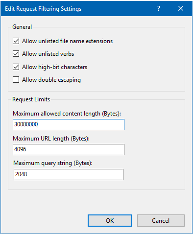

I’m looking at different settings on my IIS and the Request Filtering settings look like this for the Default Website:
Tested and confirmed!
Apparently it’s twofold. There’s the Request Filtering Maximum Allowed Content Length which was already set to 30000000 B (30MB) and shouldn’t have stopped anything. AND there’s the maxRequestLength which defaults to 4096 KB and what was probably truncating my incoming data set and causing the error.
