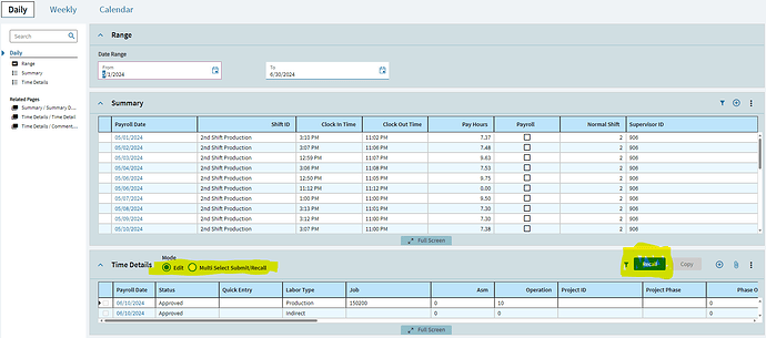

Ok… just trying to explore this path as well. I found an equivalent record in Time Entry but don’t see a “Recall” option. Am I missing it or is this not an option in Kinetic?

Yes, this is 2024.1:
Press F12 and watch the network traffic. There are some debugging threads here.

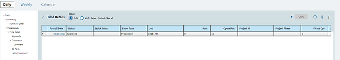

Ah, I see. I was too far down looking at the detail view instead of the list view.
Now I just need to find what permission I’m missing because I can’t see the recall button. I am very familiar with debugging in the browser, so I’m not worried about that.
