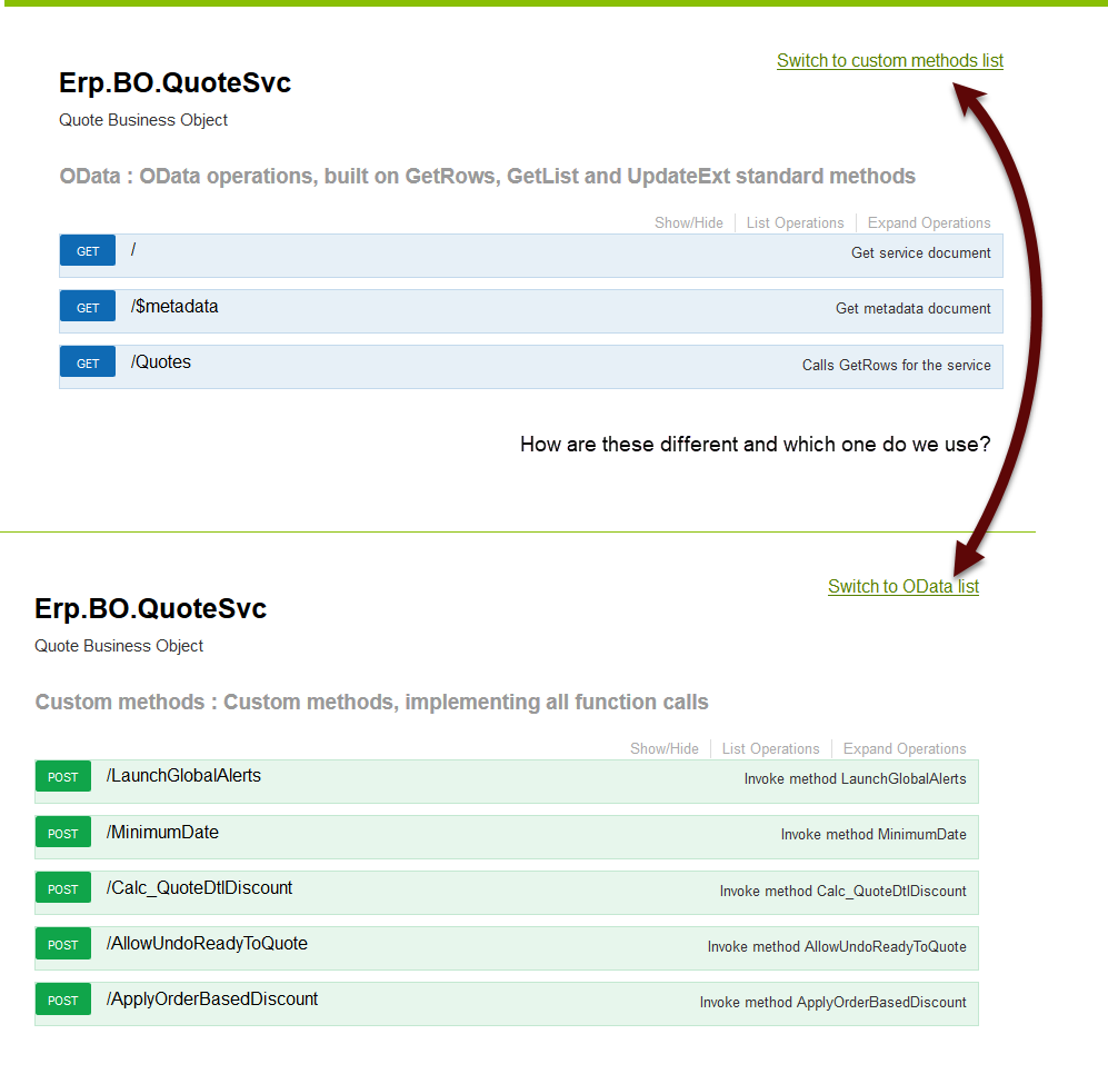

Does anyone know the difference between these two things in the swagger?
Read this. It’s a very good entry point.
OData is a set of “standard” OData methods that conform to the OData standard. The “custom” methods are really the Epicor BO methods. In most cases you’ll use the custom methods

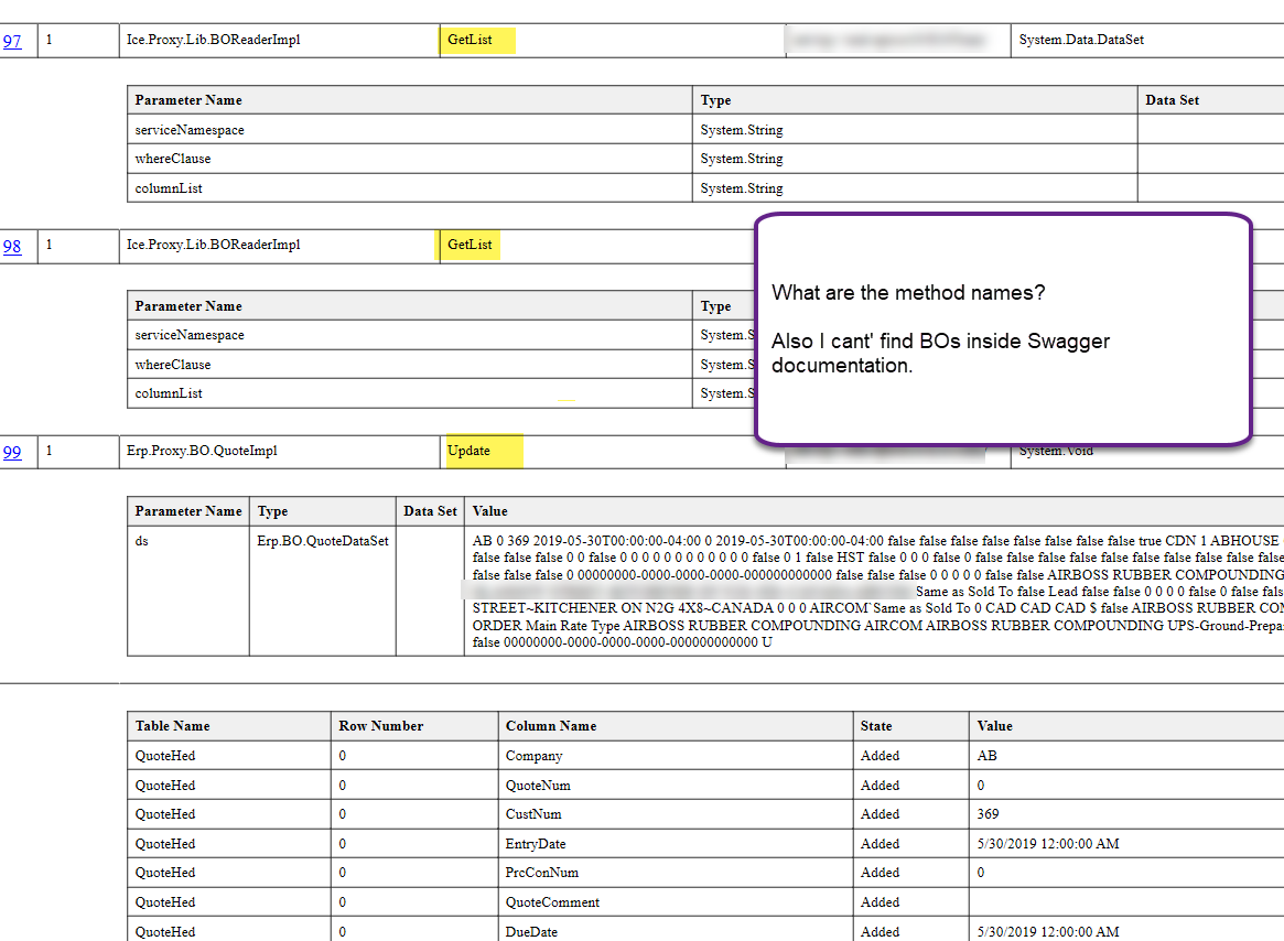

Yes, okay so I did a trace log but I don’t understand how to read it. :frowning:
But do a full trace from the beginning. And read what I’ve suggested (REST Overview Novel)
That’s good to know. I guess I really don’t understand how to read the trace log. I did read the REST novel before and skimmed it again.

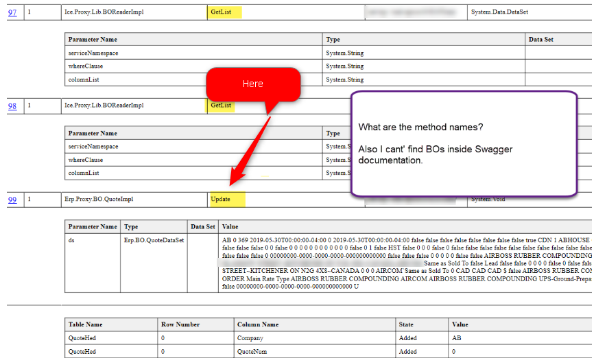

Unfortunately it never explains how to read the trace log to find out what the methods and business object to use. That’s where I’m stuck.
The trace log is sort of it’s own beast (in my opinion), but once you realize what you’re looking at, it gets easier. Like Louis said, the highlighted text you posted is the method of the business object being called. The table view you see is the dataset that’s being passed to the method.
…and what ends by Impl is the service (BO).
Okay good. So I’m on the right track. If that’s the “update” method, what is the business object that goes with it? I can’t find a BO that’s called QuoteImpl.
QuoteImpl is the same as QuoteSvc
Impl (implementation)
Svc (service)
