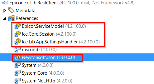

Decompiled and added what appear to be missing references:

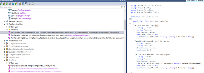

“Build()” appears to build:
And what it builds appears to have “Function” although I’m kind of in new territory for a 90s script kiddie
And that, in turn, appears to do and have what I’d expect
but no change.
