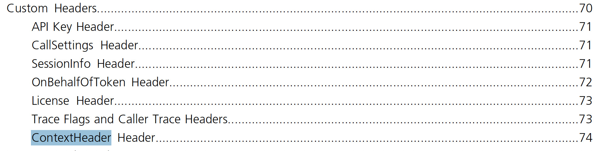

The REST guide on EpicWeb shows they are in the Headers of the call:
What??? Read the manual!?
