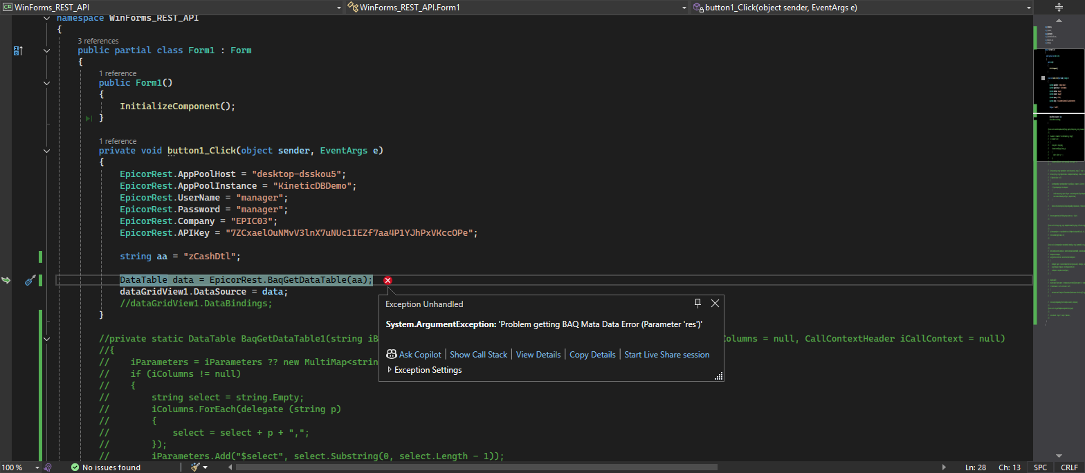

HI i like to know what am i doing wrong for this as i did not put any param for the function but it revert the ‘res’, i could not debug from the decompile dll, can anyone help?
Hi Casper,
Whenever I’ve hit this error there’s usually something wrong with the connection details. I notice your AppPoolHost doesn’t have the domain on the end, that’s caught me out in the past.
Also, I’d recommend censoring out your login credentials and API key in screenshots, never know who is watching!
