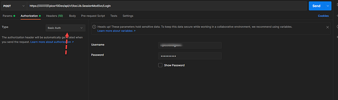

It doesn’t work in postman either? If it were me, I’d work out the plumbing there first rather than code. I’m sure you know this, but this is what a good call in Postman looks like:
