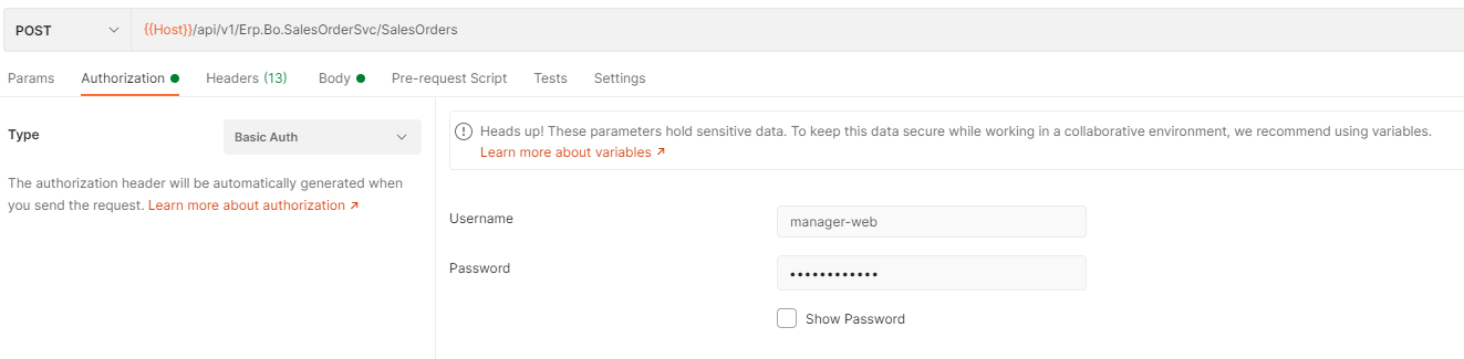

I am new to REST API and just using PostMan to do some basic GET and POST functions. I wanted to use a different set of credentials to create Sales Order so I created a new Epicor username with the same access as the “manager” user. However, when I try to use it, it gives out a 400 error.

Again, it works if I use the “manager” username. is there some area that I need to add the new user to?

Both Postman and Swagger both would not work and gives out the same error.
