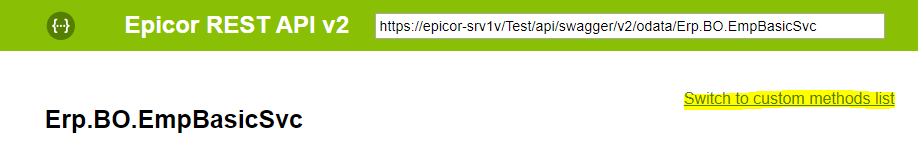

I am looking at the Epicor REST API v.2 Help Page and I do not see any reference to the API EmpBasicSvc/ClockIn? Am I looking in the wrong spot for Epicor APIs?
It’s in the custom methods list:

The EmpBasicSvc/ClockIn creates the record with zeros. If you run a trace, you can see it calls the same method that’s used for a MES clock in too.
