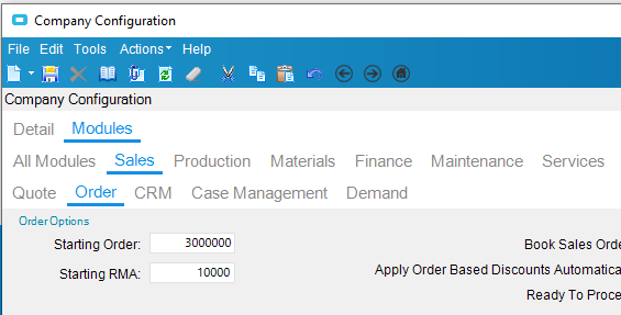

Check your company config, I think you might find your starting SO number is 1000.

@Hally I believe you are correct about this. I am testing this call on order number 1553 though. Does the starting SO number compromise this?

I might be missunderstanding you here, by if your starting SO number is less than the SO number you are entering you would get the error, if it is greater then you would get no error. That’s the behaviour I have seen using the DMT at least .

According to the first error, if you have a Starting Sales Order Number of 1000, then you can only specify Order numbers from 1 to 999. Otherwise, Epicor will expect you to give it a “0” for new Sales Orders and Epicor will create the number for you.

Sorry for the late response, (just got out of bed). As @Jason_Woods mentioned Test adding a SO in the Epicor UO first, this will confirm things like the data you are passing in is valid. You can set the starting DO number in the Company Configuration. I’ll post a screenshot when I get into work.
Company Config
