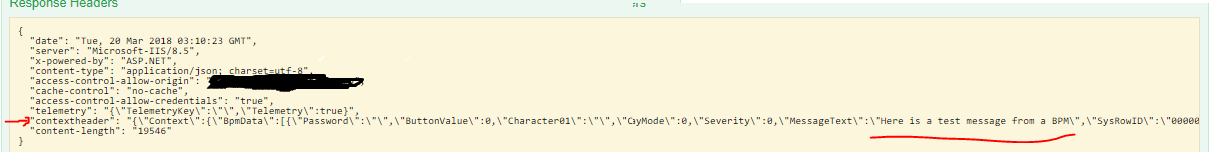

Hey guys, I am working on an application that uses the Rest services and I am now trying to handle if the user places a BPM on a method what it will do in the front end code. For an example i have placed a show message on the ‘GetList’ method of VendorSvc. This will just show simple ‘This is a test message’ whenever that method is called.
Now the issue I am encountering is that the rest service does not pass in its response body, only on the response header, therefore the application cannot access this information.
We see it in the response header. We see the bpm I placed on the method is in that data, but because it is not within the body the code cannot use it.

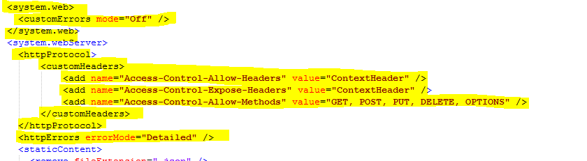

If anyone is interested in the future times. The default web.config itself does not give access to the context header variable. Therefore the javascript could not access the info. To counter this you can modify your web.config as follows.
If you have issues getting access from local host you can chuck this in the app settings to open up the origin.

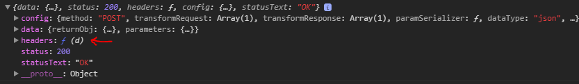

The dataset should be within this function
Example in code.
Gives this.

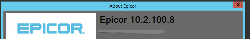

Just for anyone else that comes across this to give a little more context. The release of Epicor we are running is 10.2.100.8.
