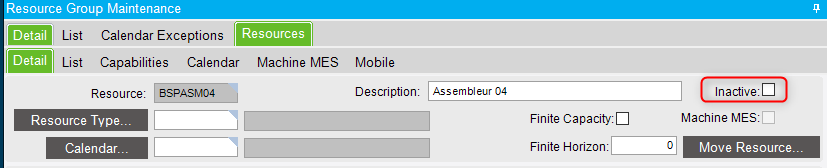

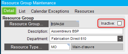

Make sure that both the ressource group and resource(s) are active in the resource group maintenance menu.

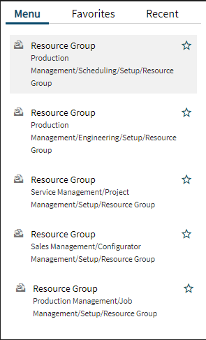

Interesting. Epicors own help has several paths to “Resource Group Maintenance” listed, none of which I have on my screen. So, I have no idea how to get to the screen you’re showing.

Make sure that everything is right with the ressource group/ressources before trying anything else.
From my home screen, if I use the search for “resource group maintenance”, it returns zero results. “Resource Group” does not bring up the right menus, either. The closest result is “Resource Group Efficiency”.

Can you open Menu Maintenance? Drill down to any of the paths shown in the picture above and see if it’s enabled.

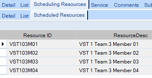

From Job entry > Operations > Scheduling Resources > Detail is the Resource Group and you can do an open with there to get to Resource Group entry (if you have permission) I have mine locked to me and one other person.
