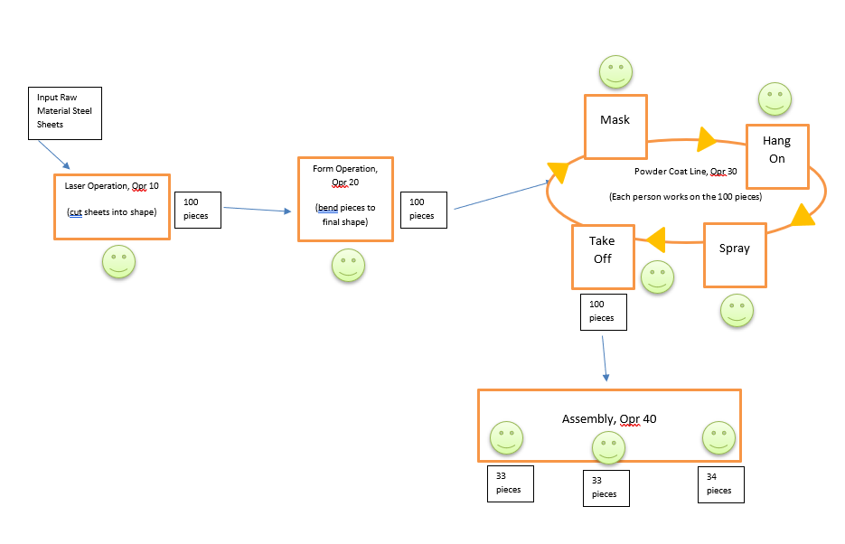

Here is a process flow for our manufacturing facility:
For both the laser and form resource there is one person working on the operation. The MES entry is set to Time and Quantity. First the laser operator clocks on/off and enters 100 for quantity. Then the form operator clocks on/off and enters 100 for quantity. The WIP quantity says 100 at this time.
Those 100 parts then go to Powder Coat. There are 4 operators that clock on/off the job. Each operator touches and works on all 100 parts. If they each enter 100 for quantity (in MES) then the total WIP will go up to 400. The pieces/hour time for powder will not get any faster, even if we add more people to the crew.
Then the 100 parts go to assembly. This is a crew size of 3. They split the 100 pieces amongst themselves, each person working on 33 or 34 parts. They can work at 33 parts per hour. If an additional person is added to the crew then they need less time to finish the task. They each clock on/off the job and enter only the quantity that they complete. Their quantities add and go back to 100 pieces.
So how should I set up the resource group/operation for powder and assembly? For powder, I have the problem that the labor quantity is adding up to 400 and this is not correct. This is also skewing the labor hours and burden cost. The real time to go through the line is 4 hours, but each of the 4 people entered 4 hours and the total labor hours is 16 and the burden is multiplied by 16. For assembly, each member of the crew should enter their quantity so it adds to the proper amount. When I add more people to the assembly work the scheduled time will drop.

Why don’t you split the powder coat into 4 distinct operation, so that the WIP quantity stays at 100 ?

When considering this issue, we must consider quantity, labor hours, machine hours, and scheduled time. For quantity, your suggestion of breaking the powder operation into 4 separate operations will solve that problem. The labor hours for each of the operations will be 4 hours and each person can enter quantity. If each of the new operations (hang, mask, spray, take off) takes 4 hours and they are scheduled start to finish then the scheduling engine will take 16 hours for this machine. We need the machine time or scheduled time to be 4 hours. I need the people to work at the same time. So I would have to set the Scheduling Factor to Start to Start. For the Powder Resource we have labor hrs = burden hrs. I think the burden should be multiplied by the the time it took the parts to move through the line (4 hours) but it is being multiplied by the total labor hours (16 hours). I could try to fix this issue by changing the burden rate.
