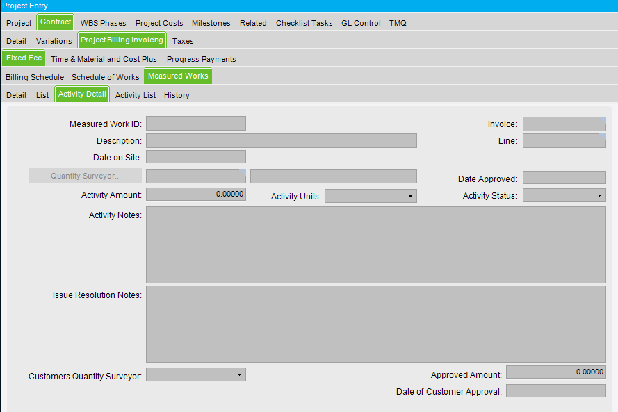

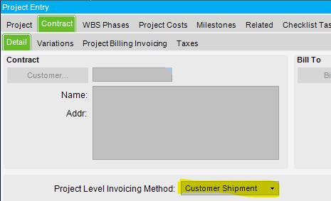

You can tell by looking at the Contract Tab and seeing if “Fixed Fee” exists in the dropdown:
When selected, you can then create stages for billing (foundation, electrical, etc.) and bill as work is done.

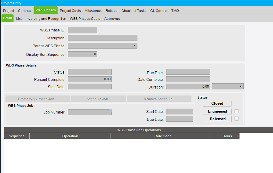

Finally, you create Phases, which are your Project Jobs.
This is where Operations come in, and therefore Resource Groups. Ernie explained this well. There is the added ability to choose roles which can have different rates when billing customers.

What you’re describing does not sound like it would need much detail in the Resource Group/Resource arena. Those series of settings are generally used more for scheduling constraints and the costs associated with operators and machines… whereas it’s more likely your costing is either known beforehand (you have a contract with your painters) or estimated somehow and then updated when you get invoiced. I’d start looking more at how you’d use WBS phases within the Project structure, and jobs related to the phases, but with a minimum of Resource Groups and Resources.
