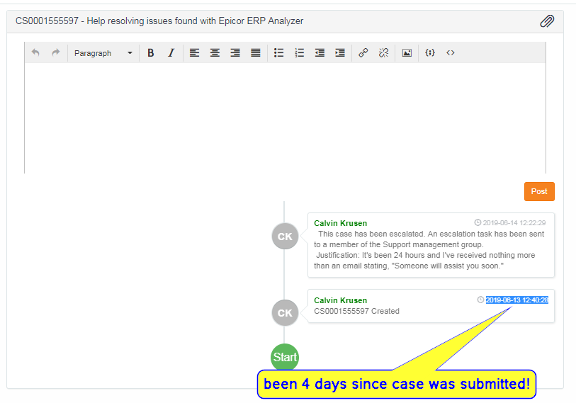

Assuming support ever gets back to me…

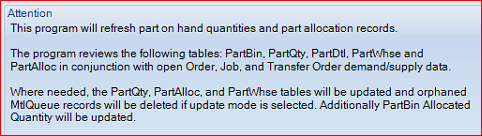

PartDtl is built from all supply/demand records. I wonder if Refresh Part Quantities and Allocations would clean up PartDtl even though it doesn’t list that as one of the tables affected.

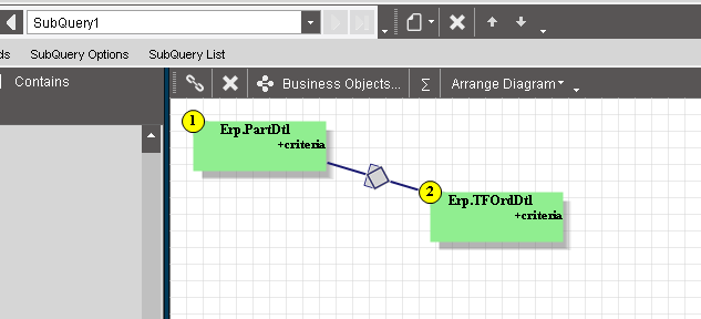

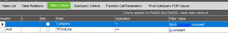

And Here’s how I’m trying to find those records

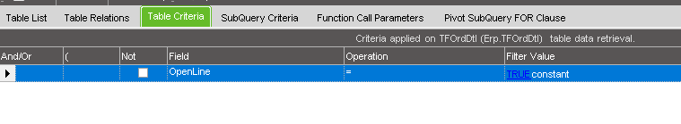

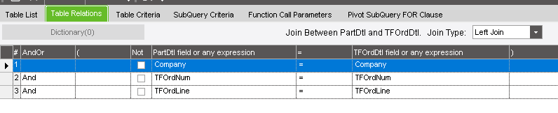

SubQuery 1 - an Inner Sub Query used by the Top Level Query
PartDtl table criteria:
TFOrdDtl table Criteria:
table relations:
Top Level Query - Consists of just SubQuery1 with a table criteria of
TFOrdDtl.TFOrdNum ISNULL
This is to show only the PartDtl Records without a matching TFOrdDtl

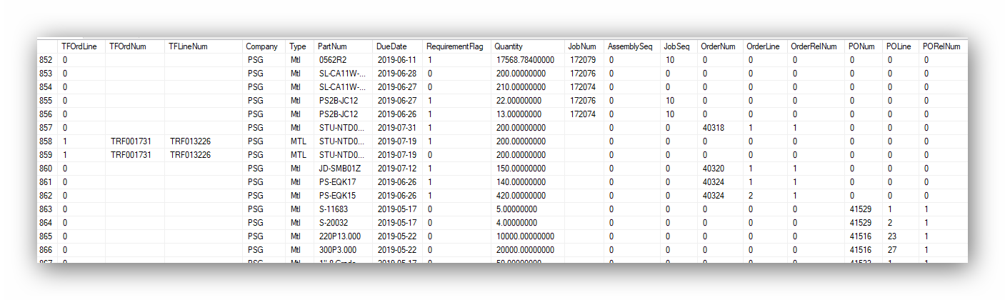

That all looks good to me. The only thing I noticed when i recreated that query in my system was that in-transit transfer orders came up as well unless you added a filter to the PartDtl table where PartDtl.RequirementFlag = TRUE. The Transfer Order Line is marked closed when the Shipment ships out, but the PartDtl record showing that the receiving plant is expecting parts to come in still exists until the TFO Shipment is received.
Does your query give you any results after you ran the data fix you had?
AFter running the datafix, it seems to have dropped from 20–some results to 15.
And I too see in-transit TO’s in my query. I added the filed PartDtl.DueDate, and see about 5 of the 15 records have very old dates (10/29/2018 and earlier), while the other 10 are 6/2/2019 and later. I assume these 10 are in-transit.
The drop from 20-some to 15 may have been due to TO Receipts, and not the data fix.
