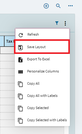

One of our user used the Save Layout button on a Kinetic grid. Its layout became corrupted and an error (no message) popup shows up when he loads the screen. I don’t like to do this, but I had to delete its layout with a SQL query (table Ice.XXXDef, TypeCode=KineticGridLayout, Key1=user).

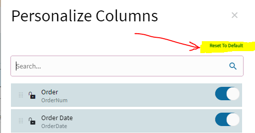

You can try this…
Save Layout button & Personalize Columns tool do seem to store the layout into the same database record.
Problem is, the screen did not load at all for the user. The error showed up, and he could not access any tool. I was wondering if there was a UI like Application Studio where you can see and manage user personalizations.
