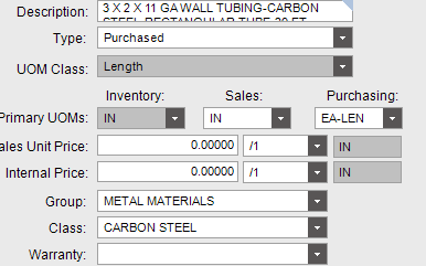

Screenshot of how most of the new parts were set up.
They do not always consume whole sticks. But my example is actually a real issue I am having and the math was easy. I need two 20 ft sticks, but the suggestion is telling purchasing to just order one 20 ft stick. The “Non-Stock Item” check box is checked on the Part Detail tab but is not checked on the Sites tab.
OK, sites NonStock setting will rule, so my first guess is that you currently have some qtys of this material in stock.
