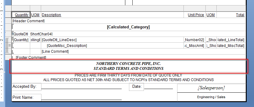

We handle this by placing the Terms and Conditions in a text box placed in the body of the report below the tablix and above the Report Footer. Textbox is set to Can Grow and gets pushed to its own page at the end of the report.
Something special like “Keep together” that forces it to the next page?
Is it just a text box in the Body? Or is it a text box in a Rectangle in the body?
I tried various things but no luck forcing a page break before it.
Just a textbox in the Body.
Edit: Yes, set the textbox to Keep Together.
That works for a single PO.
Now on a Mass Print, it only adds the T&C once, after the last PO. I tried adding it to the group footer of the tablix, but I can’t force a page break before it.
