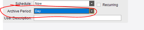

Will, archive the report for a day when you run it and see if that helps.
I have it set for a week. Same error.
