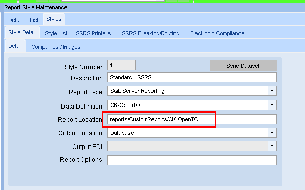

  8. Upload the report to E10 from in Report Style Maint. You don’t actually choose the RDL file, but rather the loaction of the reports folder you downloaded. For example, if your ReportStyle has teh file location set as
    reports/CustomReports/ExampleBAQ
    When you selected the location to download it to in step 3 as c:\temp, it would create the directory structure:
    c:\temp\reports\CustomReports\ and there is were the ExampleBAQ.RDL file would be.
    When you go to upload, select the folder c:\temp

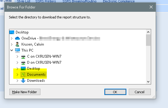

You can’t change the name or the location of the RDL you downloaded. Because the upload process just looks for the directory structure, and uploads exactly what it finds.
When downloading the following BAQ Report
I choose the location:
(note that I select that “Documents” folder, I don’t open it.)
Then I get the message:
If I use Windows explorer I can see:

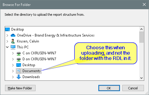

When uploading I have to pick the same location
The upload process will look for the RDL file on the SSRS path, starting at the folder i select.
And you should see:
