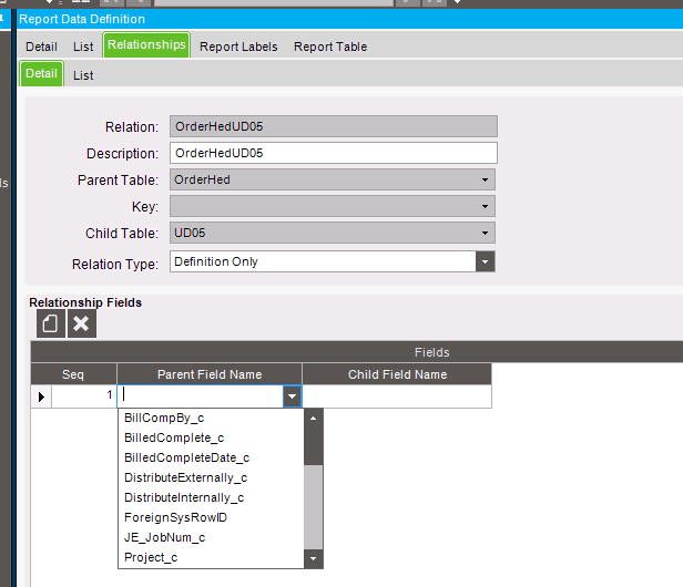

all is fine for 1 - 3. But during step 4, only the Extended UD fields of OrderHed show as parent fields:

I always use the links when I can. I only add a table if there is not an already pre-defined link.
You can always just type in the field name if it is not showing up in the dropdown. I ran into that issue once.
