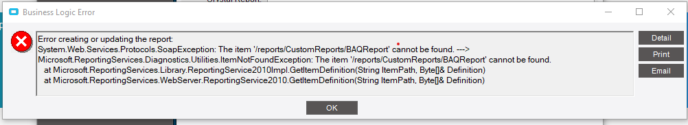

While in Report Designer, I enter the basic data, and hit save. After words I get the following error:
I have tried creating a new report under a different name and get the same response.
Try to Download the Report rdl file and then make changes, then upload rdl file to the SSRS portal.
The issue was found and it was so simple, I feel stupid for not looking first. We had one of our guys refresh the test data, and they didn’t redeploy SSRS. SO…LOL!
