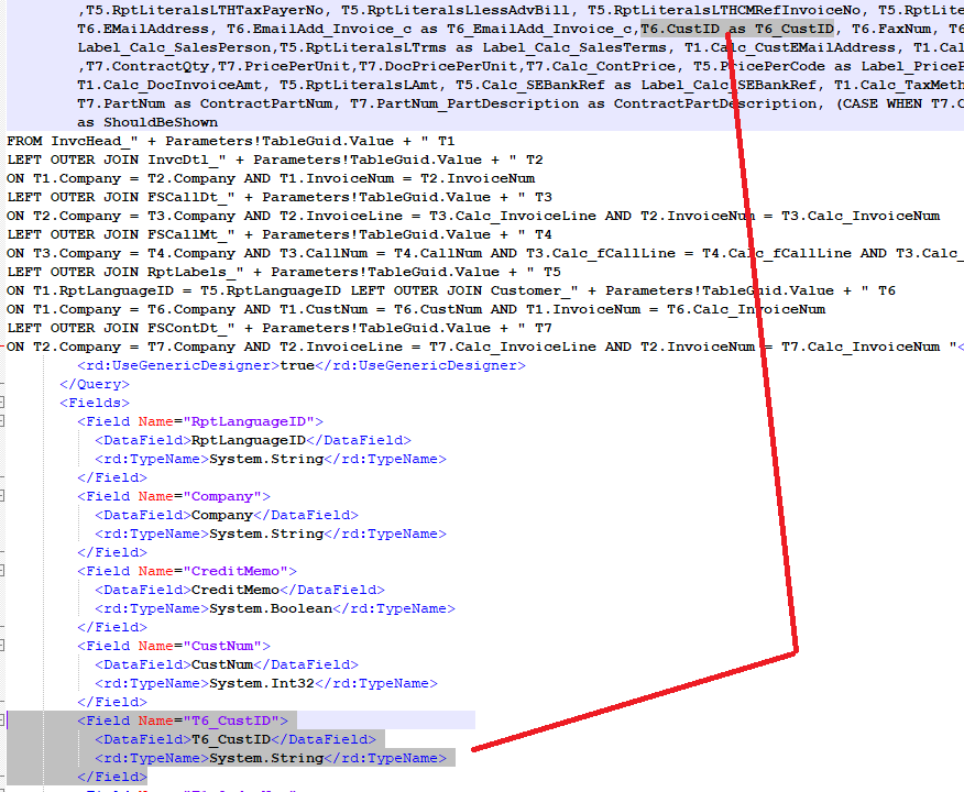

I’m not too familiar with the Report Builder, but I distinctly recall if I add fields to the SELECT part of the query, I have to also go down to the lower section of the XML file and make an entry there, like this modified ARForm report where I added T6.CustID as T6_CustID, and then I had to create an XML Reference to it in the “Field Name” section:
I’m sure, however, that Report Builder probably does all of that for you automatically, so I would first check the Report Data Definition and make sure the fields you are trying to add are included and not hidden inside the RDD itself.
