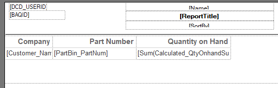

I close the error pop up and get the report builder. Using the table wizard I get this table:
When I save and upload this SSRS and test it I get the customer Name and then an aggregate sum of product for each company. So if company A has five parts with each 20,000 units it will give me company A, a blank part number, and 100,000 units.
So my question is how do I get it to the sum of goods for each part number per company?
Our part numbers are serialized so one part is only ever tied with one company.

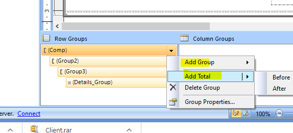

Check for Group by properties in SSRS Report Builder and add group on company column and then left click on group and select add total after for Company group, Secondly make sure your BAQ is Cross company.
