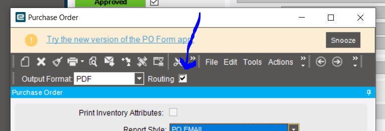

We subscribe to the Print Routing extension so that we can arrange automatic emailing of documents such as invoices/ purchase orders. It has been with us for a nearly a year and our user continue to accidentally re-send invoices/POs to our customers/ suppliers.
One reason for this is the overlooking of the checkbox that comes up when printing a document. The checkbox ‘Routing’ comes up and can be default checked dependant on the template. Instead of ‘Routing’ I want this text to say ‘Email direct?’ Or something that would flag that this box has a function that would send the document off to the stakeholder.
The word routing doesn’t really help anyone. I didnt really know where to start on this if anyone would have any suggestions
The only way you would be able to change that is to use Language Maintenance and modify let’s say the enu language file, find Routing in it and modify it. However then anyone logging in first time would download the modified language xml (automatically).
