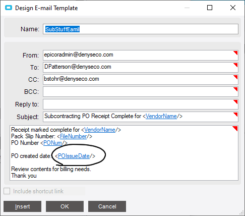

The “Set Argument/Variable” is referenced in my Email Template:

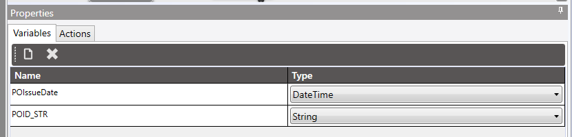

“DateTime” was the date choice in the Variable area:
You could create another variable POIssueDate_str, of type Sting, and set it after setting the POIssueDate variable.
POIssueDate_str = POIssueDate.ToShortDateString();
Then reference the string one in your field

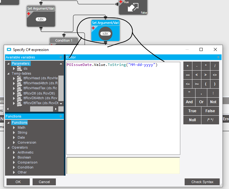

This is my attempt to follow your suggestion:
POIssueDate.Value.ToString(“MM-dd-yyyy”)
This worked!
Thanks Guys!

I hate setting my own answer as the Solution. How I arrived there was Calvin.
Adding a second variable that I could set to String:

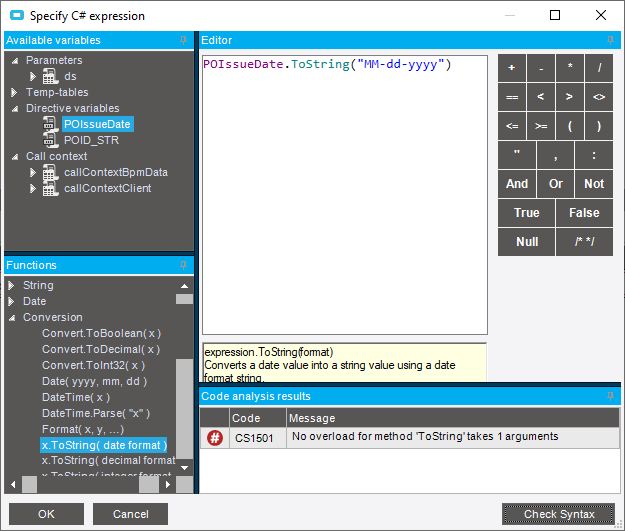

Hi Ben,
Thanks for the response, what are you using as condition statements? I have about 30+ different email alerts and that could use this quick fix as well. So your help is much appreciated. Can you potentiality have a step by step instructions?
again thanks in advance.
Adrian
I think you’re getting that error due to the semi-colon within the editor window. Take that out and you should be good to go (or get a different error at least. :slight_smile: )

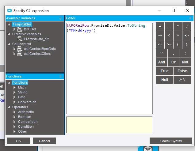

Hi Mark,
I got it figured out. for shame on my part.
Thanks everyone for your help. Now have the tools to set up the remaining email alerts. Pasted below is my working solution.
