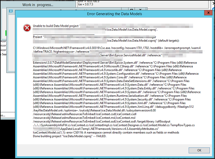

Regenerate Data Model error CS0116: A namespace cannot directly contain members such as fields or methods
When running the Regenerate Data Model task within the Epicor Administration Console, I get the following error, “error CS0116: A namespace cannot directly contain members such as fields or methods”.
Has anyone else encountered such an error and/or does anyone have suggestions for resolving it so that the normal Regenerate Data Model task can complete?
NOTE: this is in Epicor ERP version 10.0.700.3
