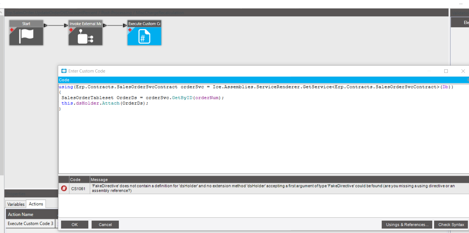

I added the refresh code to a custom code node after the external DLL call in my BPM, I get the following error, are there certain methods that the attach cannot be used on? This was a Post-Proc on SalesOrder.UpdateOrderDtlDiscountPercent
Try resultHolder Some of these don’t have a dataset that they pass at all… So they re just returning a dataset.
That was it. Thanks a ton, I’ve been trying figure that out for half the day!
