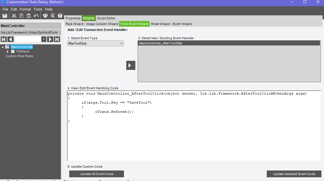

I understand that this may have already been answered somewhere but I cannot find a clear answer and I feel that this is pretty simple. Many threads are discussing using an embedded dashboard but this is just a normal dashboard. I would like to refresh the updatable dashboard right after a user clicks save.
Currently I have a customization on the dashboard using the Form Event wizard that doesn’t seem to work.
I am assuming this is a pretty easy fix I am just not familiar at all with this type of customization.
I have switched it to “SaveMenuTool” instead but it is giving an Application error:
" is neither a DataColumn nor a DataRelation for table Results."
Solved with this: Thanks as always Jose
