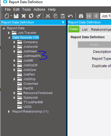

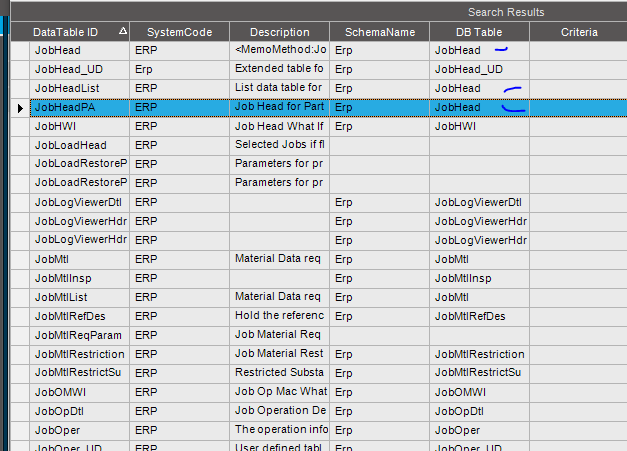

However you can include the table twice if it exists twice.
I actually use JobAsmbl twice by simply including a different alias, yet it is the same DB Table behind the scenes. But before you do that, make sure you have exhausted the Linked Tables options first. Sometimes you can just use that in conjunction with an additional Relationship.
For example for JobHead I simply used the other one, it worked exactly like the regular one, since it was the same Schema.
Maybe the List one didnt work well, but for sure the other one if I recall.
