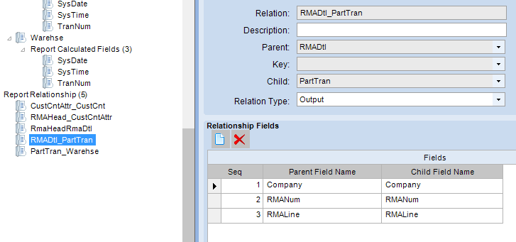

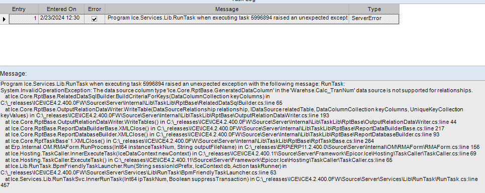

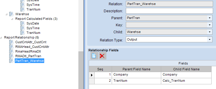

I tried adding relationships and I get nothing from the tables I’m trying to add in. Maybe this means they have no data, or maybe it means I’m doing it wrong.
Do you know how I populate the Whse_Guid parameter once I have that created?
The PartTran table holds transactional records that have happened. If the RMA has not been received yet, there will be no data. Are you trying to get this information after the RMA has been received?
I think I may be out of luck with this table, but my original mission is to get the default bins of the parts and I can get that by tying more tables to PartTran.
