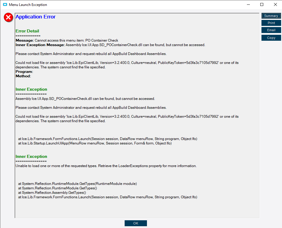

Is there a way to redeploy dashboards en-masse? We’re upgrading to a new version of Epicor and testing in our PATCH slot.
The custom dashboards don’t work in the new version unless we “redeploy” them from the Dashboard maintenance screen. Get the following error:
If I open it up in Dashboard maintenance and redeploy and clear cache they work as normal.
Instead of going through ~80 of them manually, it would be nice if there was a way to do it en-masse. Is there a way to do that?
