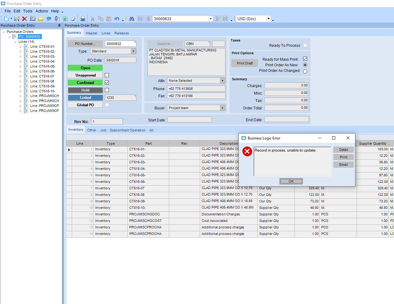

Hi,
I’m trying to unapprove a PO and am getting the below error, does anyone know what this means?
Multi company process needs to run to update the PO on the other side.
Do you have multi company setup?
Hi,
Sorry for late reply. Yes we have multi company set up. But we have customization that runs the multicompany processing for us. What we had to do in the end was update the approve status in the database delete 2 lines that were added to the ICPO manually and it fixed it.
