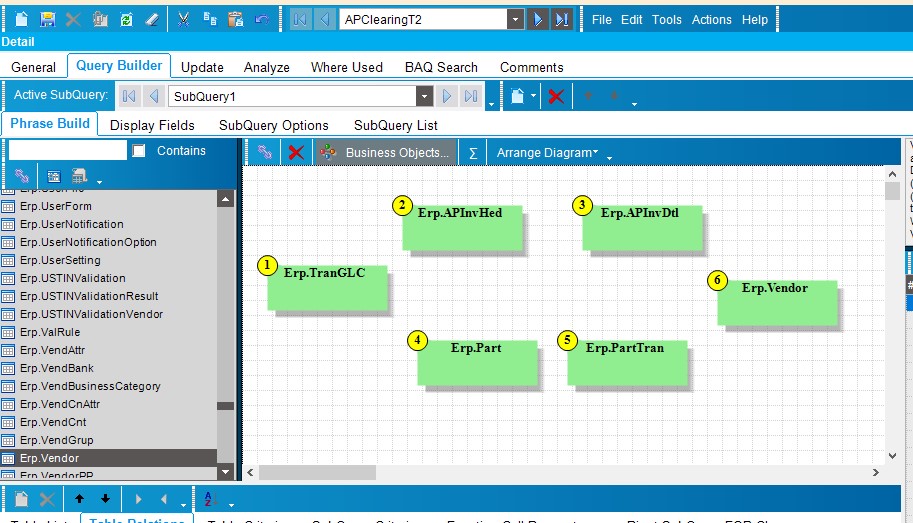

But, I still need help creating the BAQ(s). Maybe I cannot do ONE BAQ with all those tables? Maybe I need 2-3?
Maybe below?
Link TranGLC to PartTran
Link TranGLC to APInvExp and APInvDtl
Link TranGLC to APInvJob and APInv Dtl
But, I need SCREENSHOTS as I’ve tried creating and they don’t generate the correct data (missing PUR-MTL and PUR-UKN IJ codes, for example, even though I have all PUR-* coded)…
I need SCREENSHOTS:
Of the tables and joins with Table List (Query Builder | Phrase Build | Table List)
Of the tables and joins with Table Relations (Query Builder | Phrase Build | Table Relations)
Of the tables and joins with Table Criteria (Query Builder | Phrase Build | Table Criteria)
Table Display Fields (Query Builder | Display Fields | Column Select)
Table Sort Order (Query Builder | Display Fields | Sort Order)
And then any SubQuery info, if needed

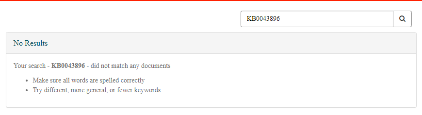

search for this KB KB0043896
OK, thanks. I did the search (KB KB0043896) and a bunch of articles showed up. Any idea what the title was?
Hi, please let me know if you’re able to send this. I appreciate it!

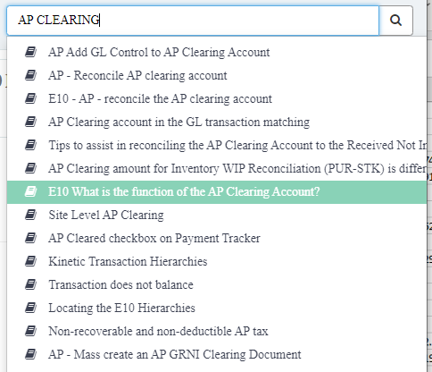

The extra KB will get you all kinds of stuff
just KB0043896 gets just the one, but searching for AP clearing will get you a few options.
I first tried it without, but it gave me an error, so then I tried with both KBs…
Well I guess just go with ap clearing which was where I started.
