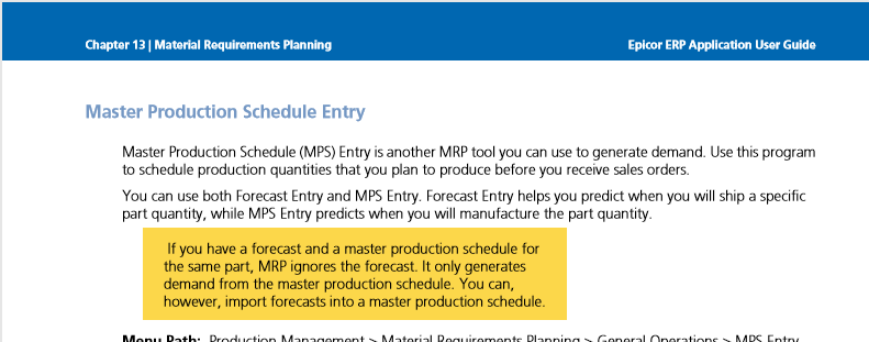

Also, there is some interrelationship when a part has both MPS AND Forecast, so be wary of that.
