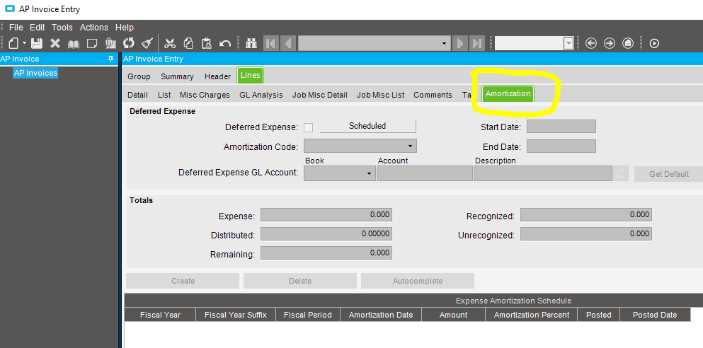

Hi,
If I am not wrong, this nature of transaction is more related to recording expenses on a monthly basis in the GL book rather than the inventory transaction (monthly receipt).
Ideal case for Deferred Expense accounting (Amortization)
One time entry
Receipt Entry
Debit Credit
Deferred Expense AP clearing
AP Invoice entry
Debit Credit
AP clearing Supplier
Menu Path:- Accounts Payable -> General Operations -> Deferred Expense Recognition
Amortization Debit Credit
Expense Deferred Expense

Hi,
You may check this option, this may be more suitable as you wanted to do monthly receipt, follow the below steps.
  1. Book PO with 1 line and 12 releases
  2. Book AP invoice as new unreceived lines (refer screen shot shown below)
  3. Post AP Invoice
  4. Book receipt every month.
  5. Use the “Invoice / Receipt Match” to match the receipt and the AP invoice.
    Menu Path:- Accounts Payable -> General Operations -> Invoice / Receipt Match
