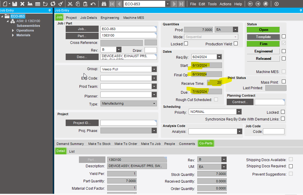

I think I understand what you are saying but the issue isnt for the Job that had the purchased part in its BOM, the issue is with the repair Job it self for the purchased part, also its not adding the dates to the beggining but adding it to the end of the schedule, like its going to take the 20 days to move the part from the Job to Stock. I pasted the Job below, you can see it has a start and finish date for 6/13 but a due date of 7/15 and receive time on the Job is 20.

The part thats on the Job above is a purchased part, It seems like Epicor is treating it like a manufatured part because its on a Job rather than a purchased part which it is marked up for, strange…Im not really sure how to get around this then
