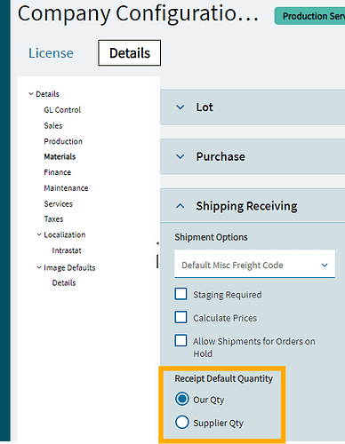

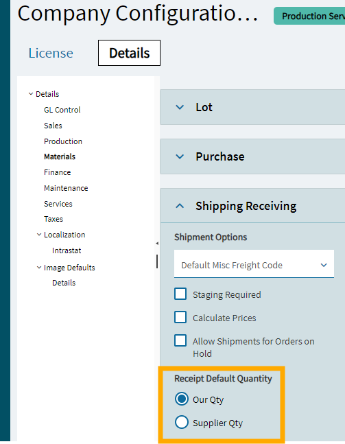

@JasonMcD The default is in company configuration and it defaults to Our Qty. I recently changed this and am on the we should buy what they sell bandwagon for 2025. I believe this will solve a lot of our AP automation receipt matching issues.
Well there it is. Awesome, thank you!
8 years and still learning new settings.
As a parting rant, the default default really should be supplier qty, IMHO. That probably would have helped a lot over the years. (No surprise, I have other examples…)

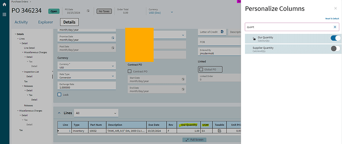

@gpayne You undoubtedly know this, but I saw that there is an equivalent setting for the PO. I feel this also falls into the same line of thinking, so I changed it. Well…
Fun fact #1: The grid view of the lines does not show Supplier Qty by default. So you have to unhide it, fine.

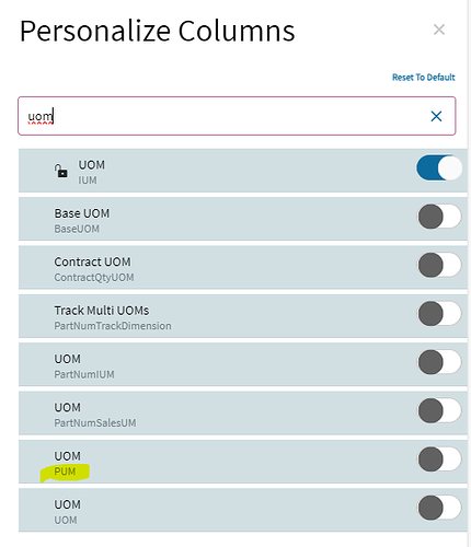

Fun fact #2: The grid view of the lines does not show Supplier UOM by default. Ugh, now I have to tell users to search for this, too. It’s the 7th UOM field.
Fun fact #3: I cannot find where Application Studio is hiding the hidden columns. (Not where I hide columns in my apps!) I thought about trying to load the columns in for the users.
If I add these columns, won’t it have them in there twice? Would I even care, since the original set should be hidden?
