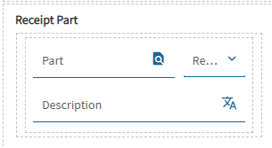

Pretty evident based on the title, but I am wondering why only certain fields have an ‘Open With’ context menu, but some don’t?
For example, PO, Job, Warehouse and PCID are fields that have the ‘Open With’ context menu, but the Part field, which I consider pretty important and frequently used, doesn’t?

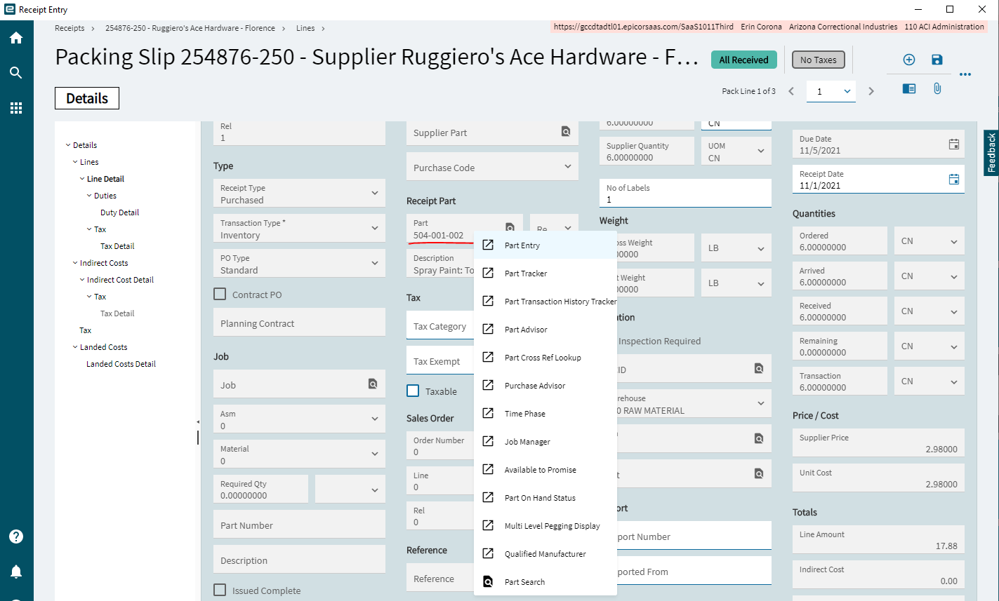

My Part field’s Open With seems to work fine.
Maybe were you trying to right-click from within the “Our Part” field?

My apologies if I didn’t make it clear, I’m using the Kinetic web form version of the screen. And it’s the below field.
Hi Jordan,

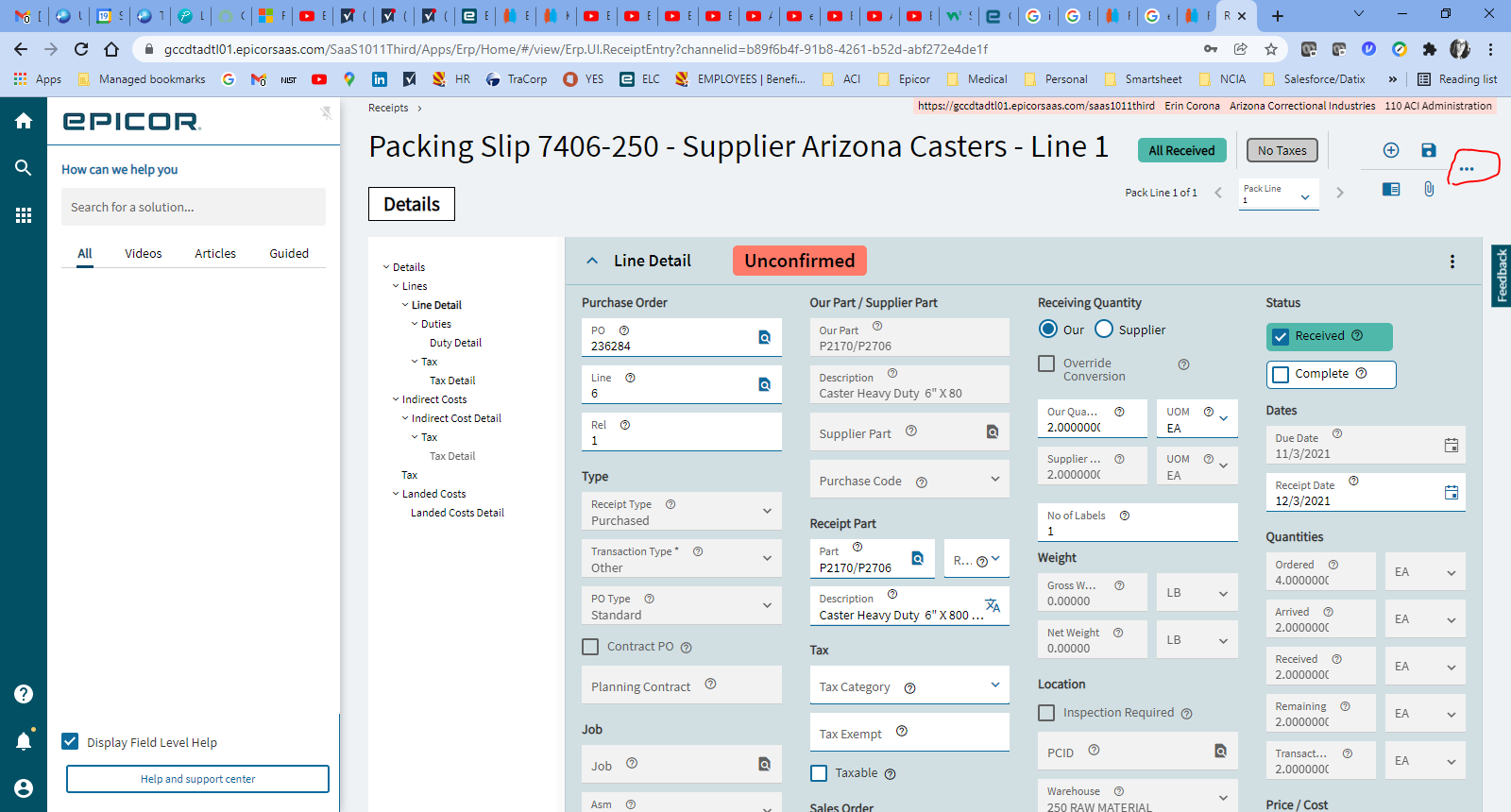

I pulled up my Kinetic version, and I am still able to right-click and get an Open With menu. What happens when you right-click in this field (assuming it’s populated, obviously)?
Yes it’s a populated field. I get the Context menu showing with a ‘Loading’ icon.
Then when it looks like it finishes loading…nothing…
And then when I right click the field after that, nothing.

This is a really weird issue and I can’t figure this out at all. I see a ‘Loading’ popup for the Context menu, but when it does load it just goes away, and then after that when I right click, it’s like the system doesn’t register that a right click has happened.
