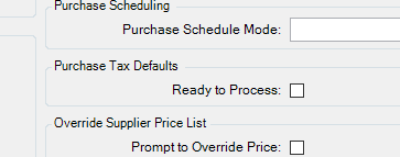

After exhausting nearly all avenues I discovered that the Purchase Tax Defaults ->Ready to Process flag in Company configuration had been checked. This was adding additional updates to the POHeaderTax, PODetailTax and PORelTax tables.
Unchecking the flag reduced the creation of lines to 14 seconds. Still not what the developers are seeing but more acceptable.
