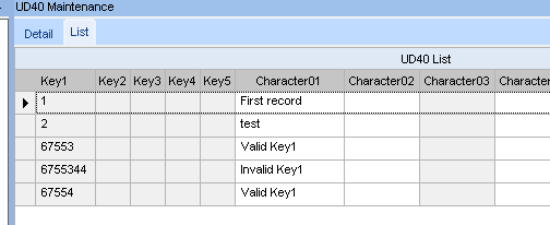

That yields column Character03 as read only. It might not be obvious on the screenshot, but Char03 is grayedout.

Yeah something is strange. I thought maybe you were trying to do it dynamically (like when another field has a certain value).
So I did some experimenting, which included commenting out all the wizard added code. But that column is stuck on being ReadOnly now.
I completely removed all the added code but it is still stuck as ReadOnly.
