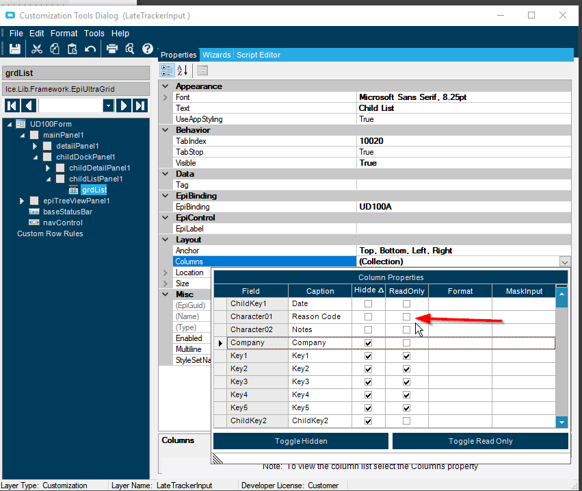

Can someone tell me what’s the point of having this check box in the customization tools if it can’t actually control read only in the grid or not? I want to control the field with the epicombo that I put at the top of the page (that works fine), or make the grid a drop down. So the easiest way to do this should be to make the column in the grid (only) read only. Hey there’s a box for that! But when you click it, it reverts back to the extended properties value. But if I make the extended properties read only, it’s read only everywhere.
Do I really need code to do something so simple?

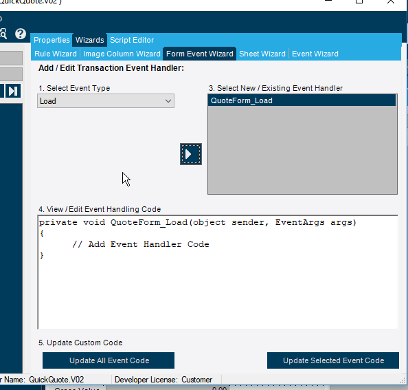

I’m customizing our Order Entry form with a UD table. I used the customization wizard to create the bulk of the initial code. Perhaps I shot myself in the foot doing this. I’m attempting @josecgomez solution but it’s not working as I don’t have a Initialize_Row event.
I’ve been trying to set the column read only in the wizard created events but getting no where it seems.

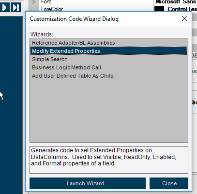

If you use the wizard for setting the extended properties, it should do all of that for you.
If it doesn’t show up in there, you should be able to do it on a form load event added by the wizard like this.
