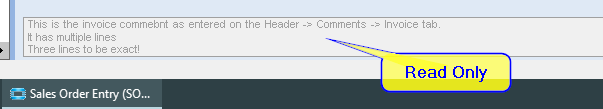

So you want a custom control to be bound to the same data source as the built-in control. And the custom one to be read only, while the original built-in field remains editable?
You can set the custom control’s Enabled = FALSE, and it will still be visible (though light gray), and users won’t be able to edit it. But they still can edit it on the Comments -> Invoice sheet.
The custom control on the Summary sheet:
The original control:

See my post with the picts. I added a textbox to the summary sheet, bound it to OrderHed.InvoiceComment, and set the control’s Enabled property to FALSE.
