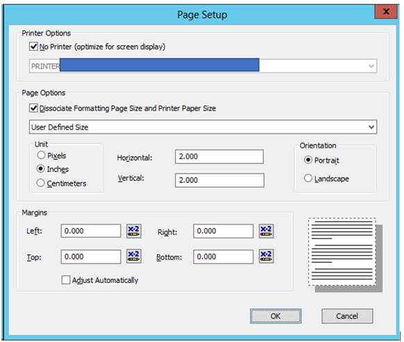

If you open the label in Crystal Reports and click on File - Page Setup you get the options below. The options selected are the ones that work best for us when printing labels.
Are you trying to use a sheet of labels? Then you need to set Crystal up as follows:
Page Setup should be for the sheet size (A4 in your case). Do like @ERPSysAdmin said: dissociate the page size, and set margins to zero (you may have to set these to whatever the “margin” is from the page edge to the edge of the label)

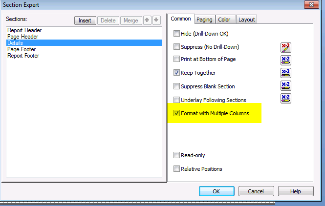

Enable multiple columns in the section expert

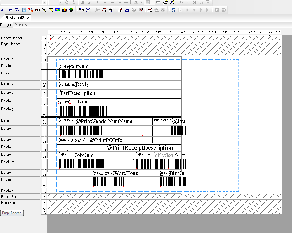

Set the individual label size and spacings in the Layout tab
The design view will show one row of labels, but on the one with white background is the one you design in. moving a field in the white area, automatically moves the same field in the “other” labels of the row. The corresponding field in the “other” labels doesn’t move right away. If you preview the labels and then return to the design view, the “other” labels will reflect the moved field.

UPDATE: We got a little further but its still not how we want it…so in crystal we have page setup settings of: A4, portrait with 0 margins.
In section expert/details/layout we have 12 x 9 cms and gaps of 15cms x 15cms so that essentially 1 label fits on one “page” before it is ripped off at the perforation.

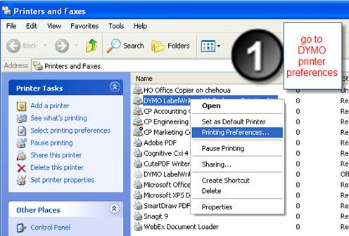

The computer connected to the DYMO needs printer preferences set in order to have the labels print properly. This needs to be done one time on a computer. See screenshots below.
Right click on DYMO in printer list (i.e., under control panel) and select printer preferences.

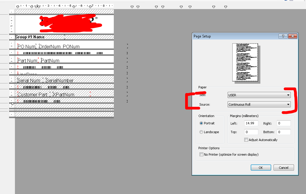

Looks like you need to select the correct label printer within the Report. If still not there, the steps above your post with images would be my guess. (late reply I know…!)
