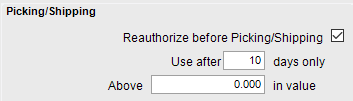

If you use fulfillment workbench and pick orders, you can change the credit card conf to re-authorize on picking. Not sure if just printing a pick list will do it.
Thank you. We do have that option enabled. Unfortunately, it still slows down the process when the order has to be pulled out of the regular picking flow, and then customer service has to attempt to get in touch with the customer when the re-auth is declined. Maybe we should change the days value from 10 to 7, though…

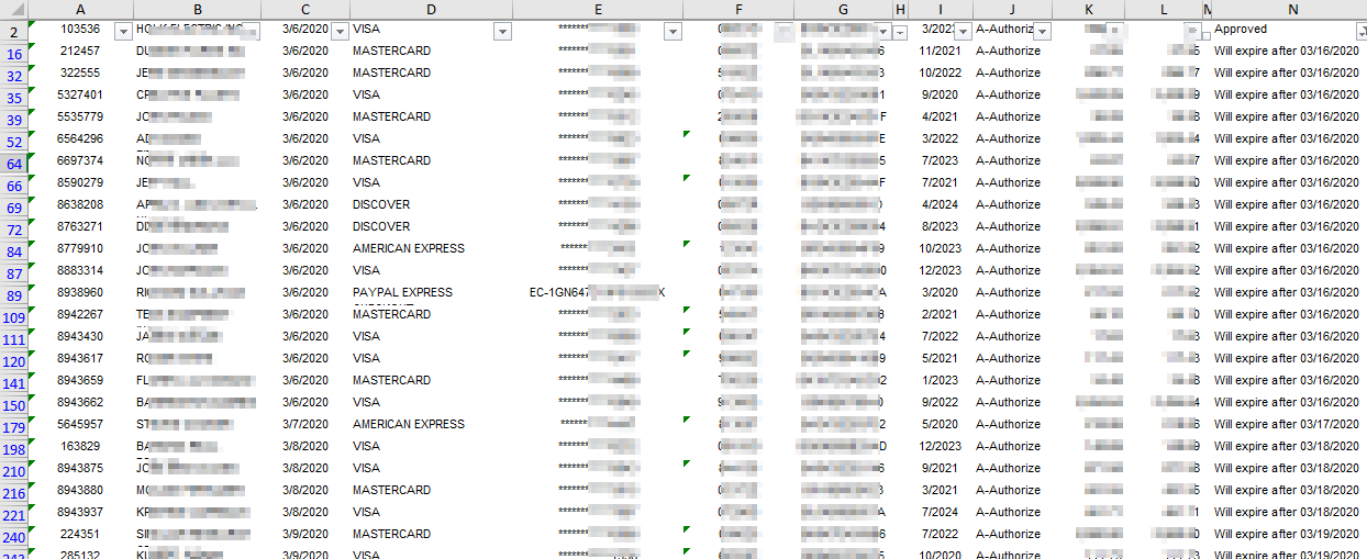

We are a little closer - We took the Credit Card Report, and customized it in SSRS to have everything show on one row, then viewed it as EXCEL instead of PDF. Not that I can do anything with that yet…
