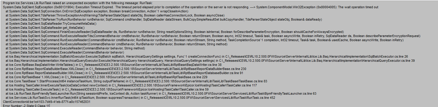

System Monitor
Nothing in the event viewer on the app server, but i did find the same error on the task agent server
