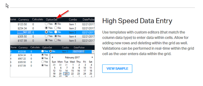

The option set is something that looks like it’s available in the infragistics tools set. Can this be made to work with E-10?
Yeah you should be able to use that, it would require to custom code it, but yes.,
in your opinion, would it be easier to code check boxes to act like radio buttons (I have dabbled a little bit with that type of thing, basically set values on row change) or use this option set tool?
No experience personally but according to Infragistics:
Putting radio buttons in a cell is very easy. What you do is place an UltraOptionSet control the form with your grid. Populate the OptionSet with the items you want (Yes / No / Not Sure). Then you set the column’s EditorComponent property to the UltraOptionSet control.
When the user selects an option, the cells value will be set to the Value of the selected item in the OptionSet.

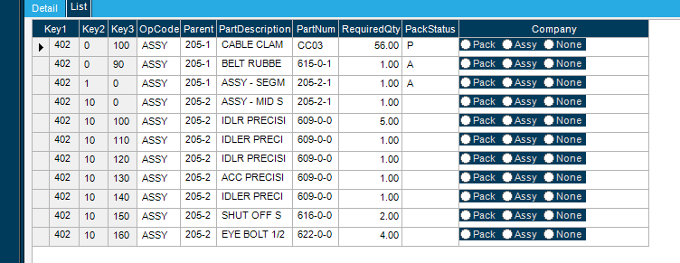

So the form opens with no errors, however the option set/radio buttons are not there. But it did do the resize columns, so something is working.
Update:
I changed the column number to 0 and now they show up under the company, so I think I just need to figure out the column number for my UD field and give that a shot.
Update 2:
So it doesn’t seem to like the extended UD fields. It works with the Character01, so I will probably just use one of those instead of making a field with a name that means something.

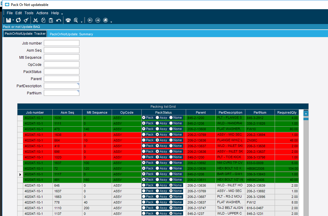

So now I have radio buttons, in a grid, in a dashboard. This is a rough prototype.
Next question is about styling. I can’t find anything about styling the radio buttons, but I figured I could use row rules. This seems to work ok, however, once I get the final version, there will be more options, and I fear that I will run out of styles.
Here is the autogenerated code for the row rule. Is there a way to just change the color instead of the whole style? Or can I make my own styles and set the color there?

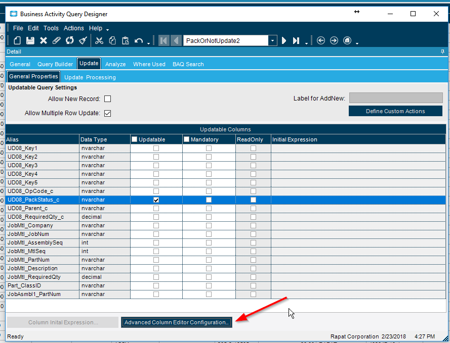

Here’s an interesting tidbit in case anyone cares. If you use the advanced colmn editor configuration in the Ubaq, you can set a radio button configuration in the Ubaq.
Then you can add your options in the BAQ
Then when you put it in a dashboard, it automagically makes it a drop down for you.
I’m still going to change mine to radio buttons, (I guess it would be nice if this carried over into the dashboard as radio buttons…) but this could still be helpful for something else down the road…
