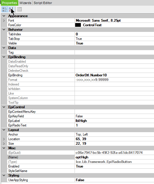

I have a set of radio buttons within an Epic Group. They are working to set the value and write it to the table. However, when I open the form the value in the table is not being displayed on the form.
The Radio Buttons need to have a value associated with each one. This value gets stored in the EpiBinding field. Could you screen shot the properties of one of the Radio Buttons?

We are hosted so it is a big deal to get the database reg. It is working and the vlaue of 1 2 or 3 is writing to the number10 field. This field is then being displayed on several dashboards and all this is working fine. I am only stumped because I cannot get the radio button to display the value that itis saving in the data base.
